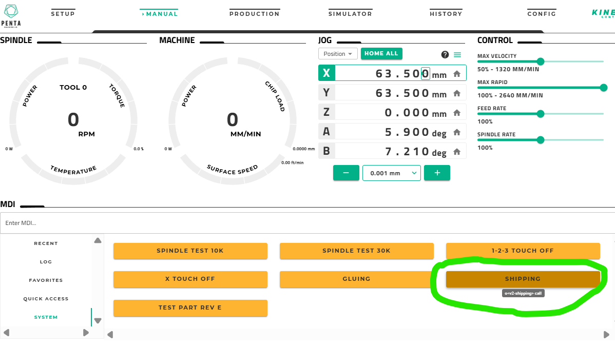

Do you have Kinetic Control? If I remember correctly, there is a built-in command in the “manual” pane that is something like “SHIPPING”. When you execute that, the machine moves into position where the bolts can be inserted.
yes, you will find it here.
