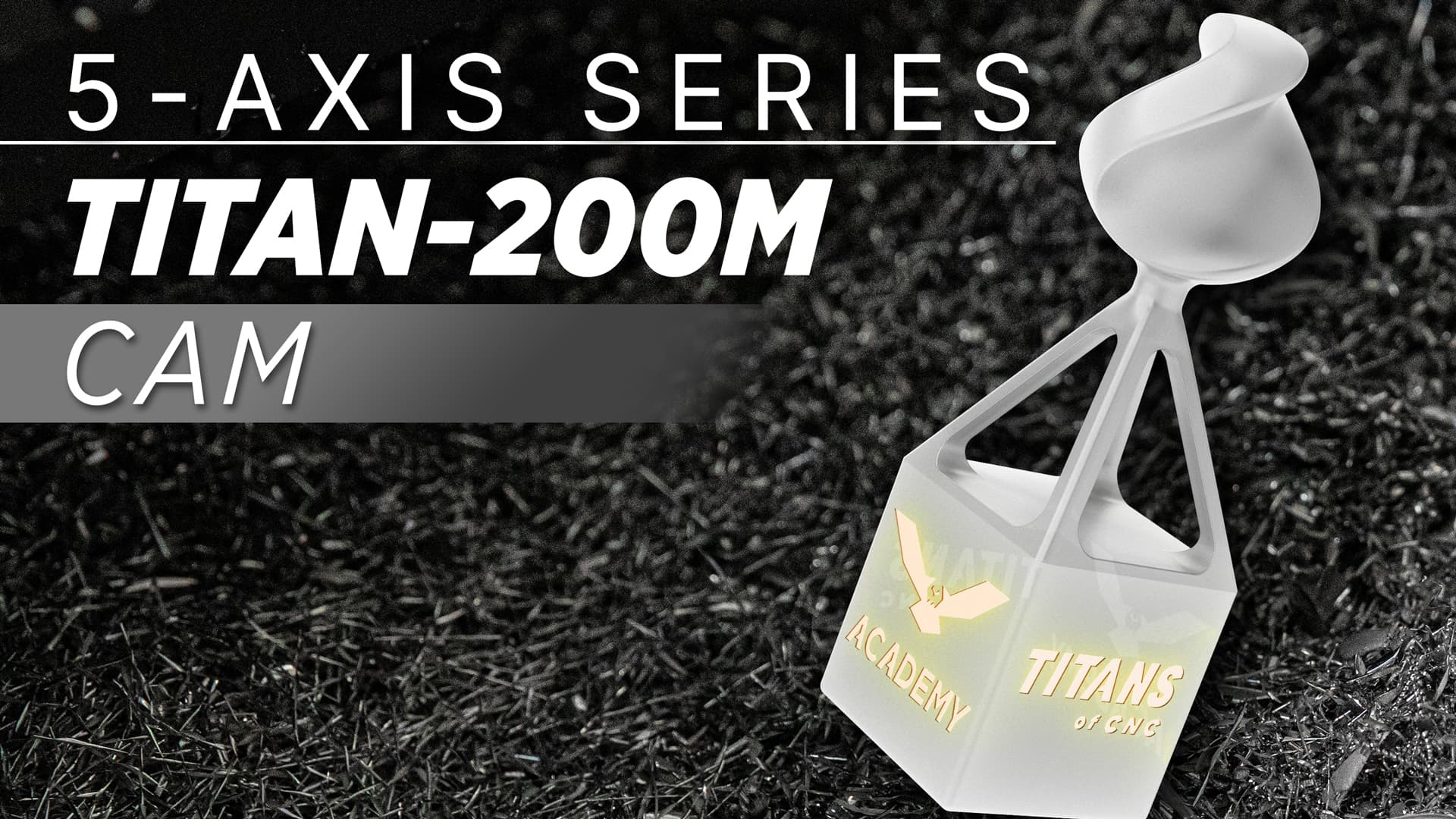

Hi, I’m producing this Titans of CNC part :
Using pretty much the same toolpaths as in their demo videos. I am not in a rush to produce parts either, but the point of the demonstrations is to show the potential of a machine and it will often be re-running an already machined part, so no material removal…
I’ve now noticed that turning he veolcity off and back on makes the machine come back to normal speed, but for a variable time before starting to “hiccup” in it’s motions again. I have a video I will try to link in this thread.
