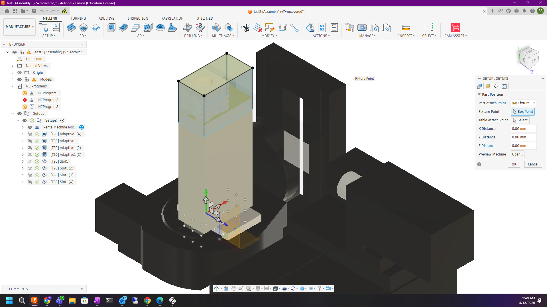

i am new to Pocket NC and Fusion. i am looking to make sure i setting up Correctly. Is anyone available for a teams call.
i can share any files needed. This material for final part is copper. i am trying to use Machine Wax at the moment.
Make sure you set-up work co ordinate system (WCS) at top corner, and also in tool strategy WCS must be at top corner.
i currently have it set to B Table Offset. i will change these and see how it does. Thank you.

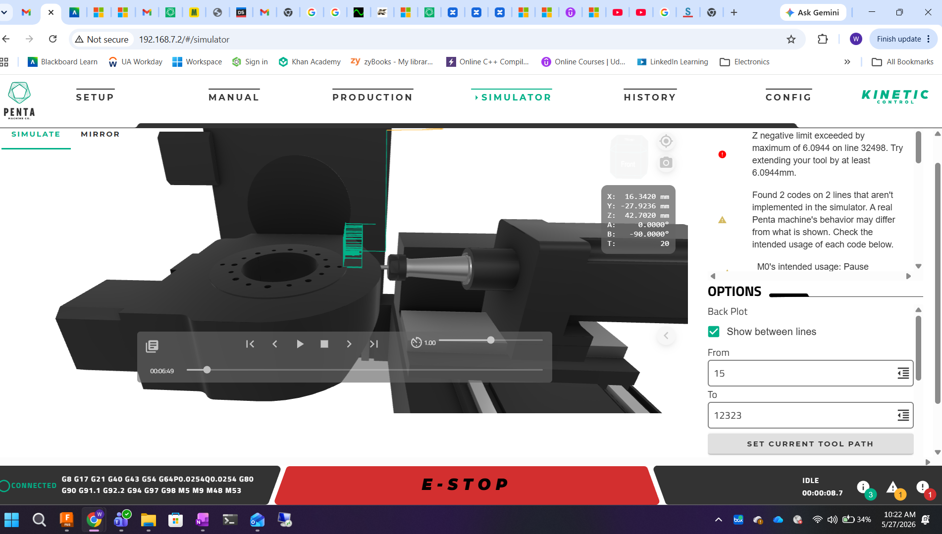

As I can see that Z limit is exceeding, after setting WCS on top corner of stock. Check - Part postion on machine in stock setup, it must be aligned with machine’s centre.
