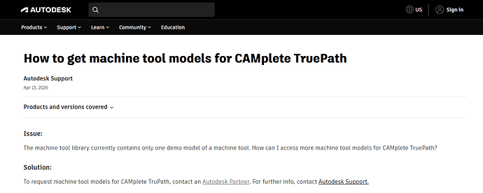

I am testing out a couple machine simulators (specifically CAMplete and Vericut) and was hoping to try them with my Pocket NC V2-10. Unfortunately, I haven’t been able to find a “machine tool model” for the Pocket NC that can be imported into either software.
Autodesk says that I should contact an Autodesk Partner to request a machine tool model (see image below), but I wasn’t able to find a partner that supports the Pocket NC.
Has anyone dealt with this before? Not sure how to go about finding the necessary Pocket NC “machine tool model” for these simulator platforms.
