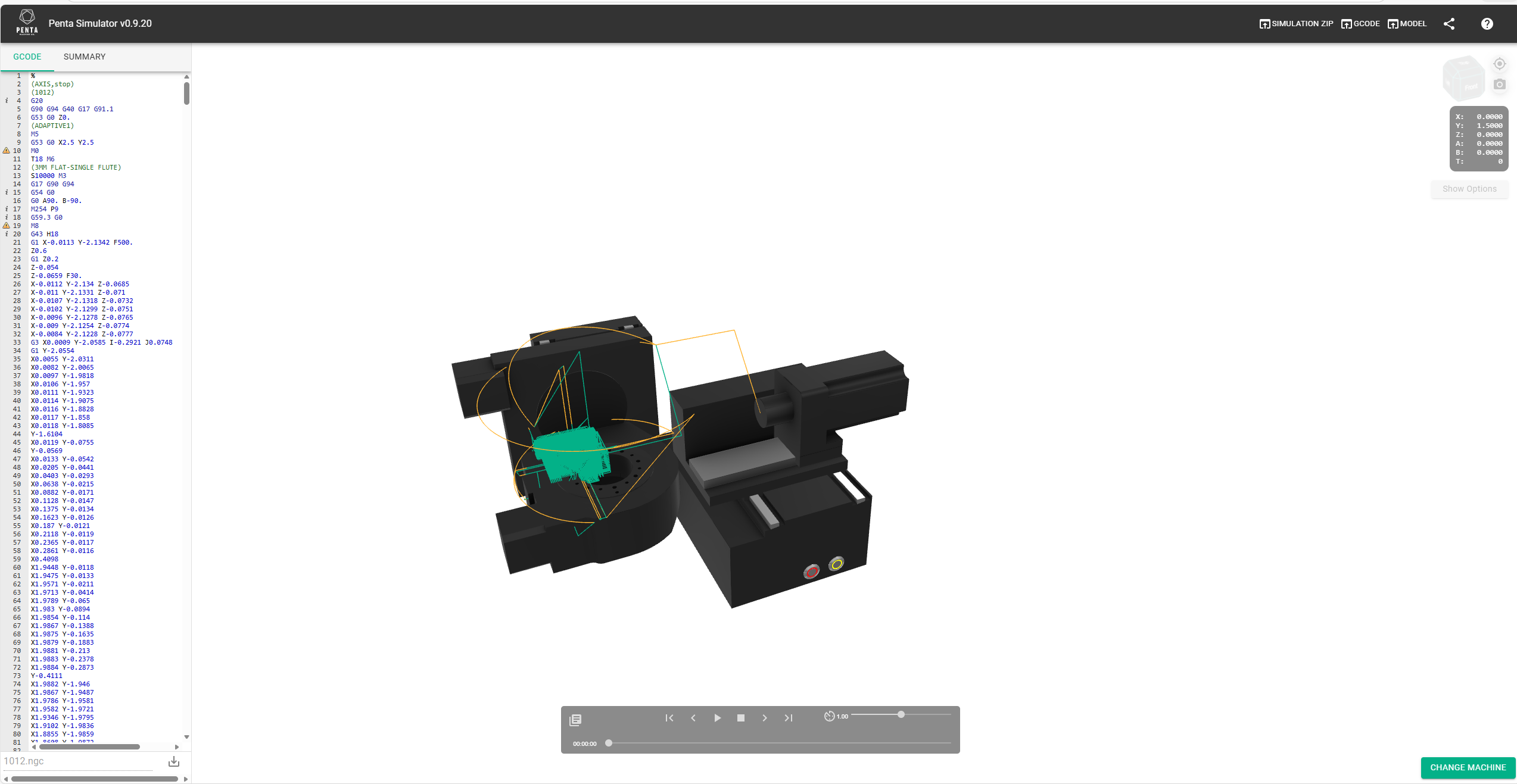

I have an issue with the penta simulator, when upload the G code from fusion the part is not centered.

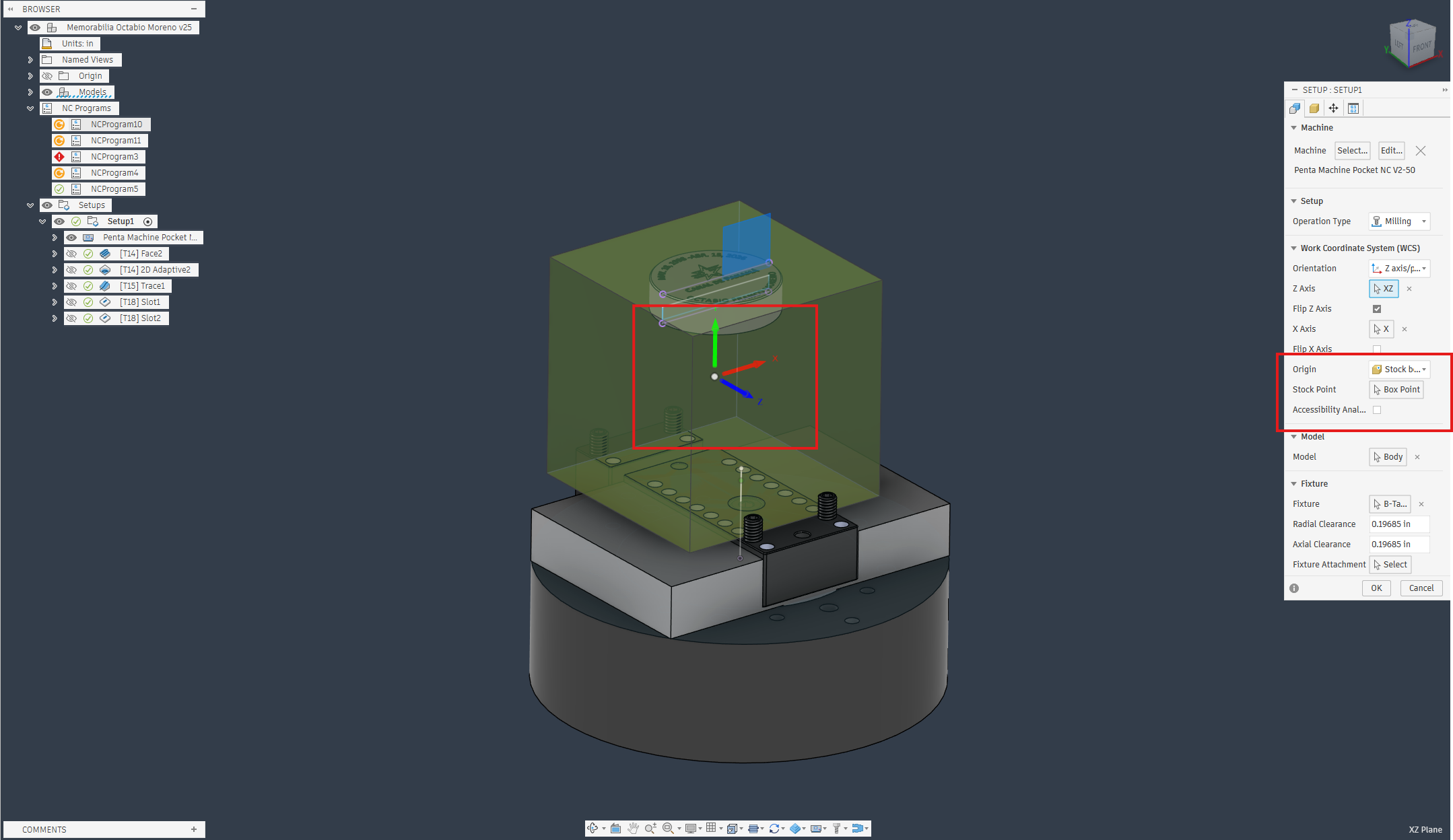

i was following the tutorial for first part and placed the wcs as it was.
Does anyone had a problem similar with penta simulator?

The offset is likely an issue with the origin of the part, any chance you can share the Fusion 360 file?

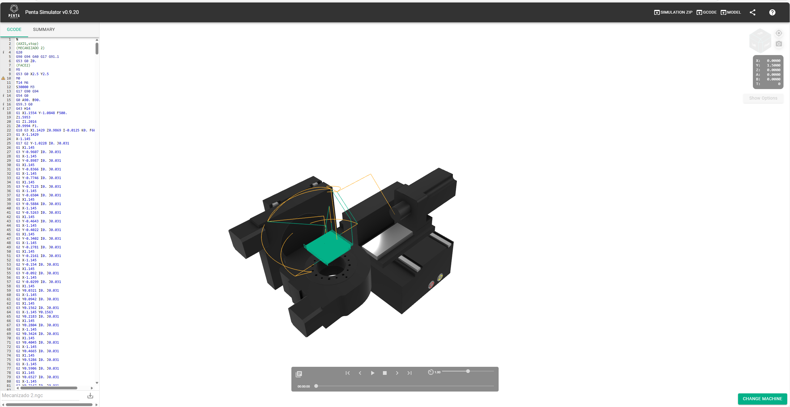

It seems is the origin of the setup , when i place the origin in a corner the simulation is not centered , when i place the origin to the machine origin it works well.
