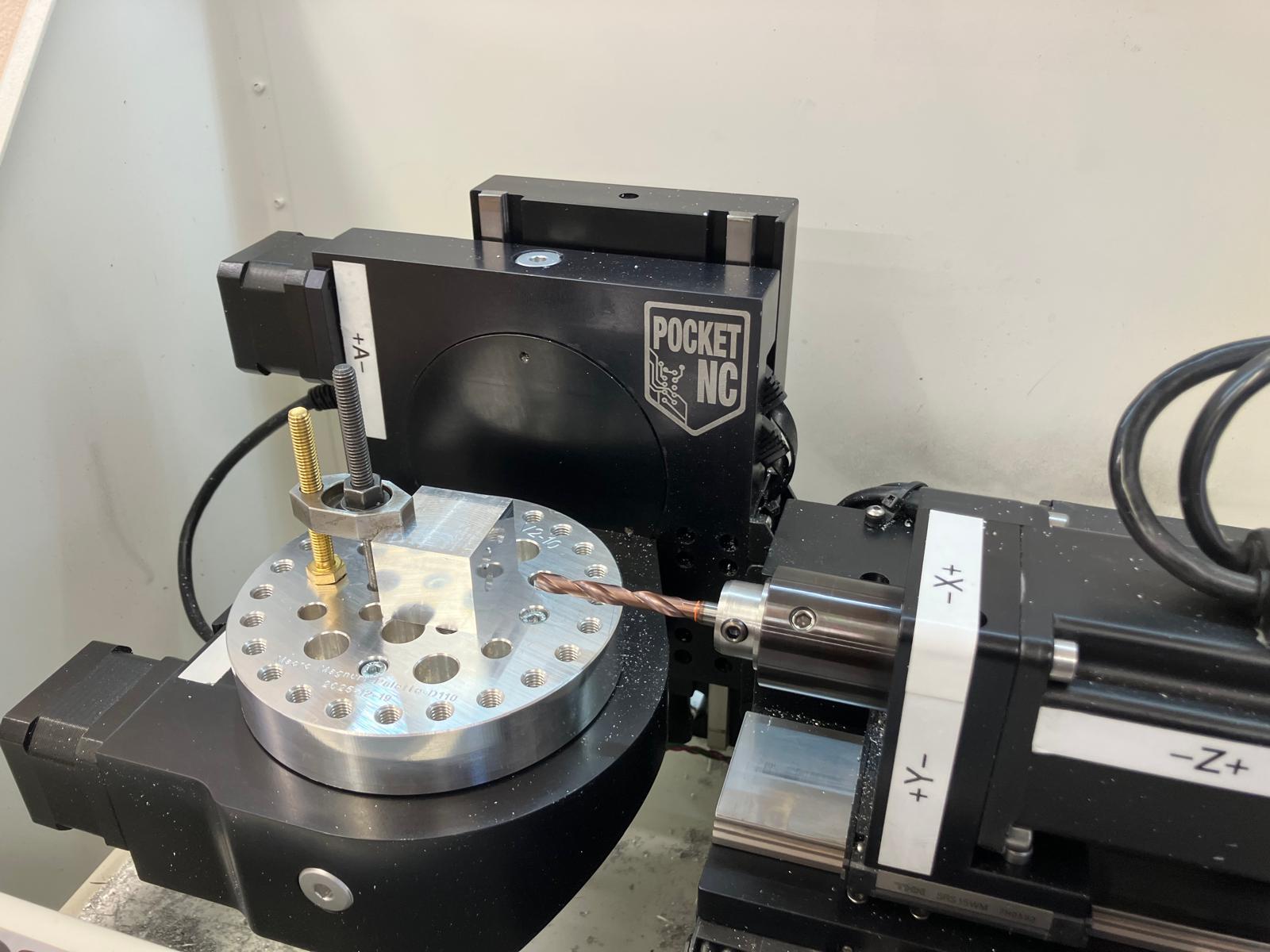

Hello everyone, hello Penta Pocket team,
I am having problems drilling a Ø5 hole with the Pocket for M6 thread milling with a cutter.
I cannot get a hole into the workpiece.
Is the drill too large for the machine, or is the machine’s power too weak?
The machine vibrates and the spindle stops and sounds terrible.
I want to drill an aluminum block.
Drill cutting data: S3000, revolutions, feed F100, depth 0.7mm, retract cycle.
It is a solid carbide aluminum drill Ø5mm.
Has anyone ever drilled holes? I am programming with Fusion.
What do I need to change in the process to make it work?

Assuming that your feed rate is 100 mm/min, that operation needs 0.06HP (44 watts) and 0.11 ft-lbs of torque. I don’t have a PocketNC, but you might be exceeding the power and/or torque limits of the mill. I’d try drilling an initial hole with a 2- or 3-mm drill bit and follow that up with the 5 mm drill. The 5-mm drill should then need less power to drill the hole, dunno about the torque. You might also try manually applying a couple drops of Tap-Magic Aluminum or similar to the tip of the drill. I’ve found that helps reduce friction and buikt-up edge with aluminum.

The solid carbide drill D5 (M6 thread) is too large for the pocket, the spindle power is too weak, the torque too low, and the spindle power too weak. The machine can’t handle it, the spindle stops, and it goes into error mode.
I chose the drill-milling operation. That worked well.
Technical data for the solid carbide cutter (Company Hoffmann, Manufacturer No. 201070/167970):
Master Alu solid carbide shank cutter HPC, uncoated, DC: 2 mm
Number of teeth Z1
Speed S9000 rpm, feed 100 mm/min, depth angle 2°
I produced the hole in a process-safe manner.
I work completely dry without MQL (Minimum Quantity Lubrication), air, coolant, or oil.
I have no experience with Tap Magic Aluminum.
Is there a way to lubricate or cool so that the tools don’t wear out and the surface quality in aluminum improves, and the chips are removed better?
I would be happy for any help.
